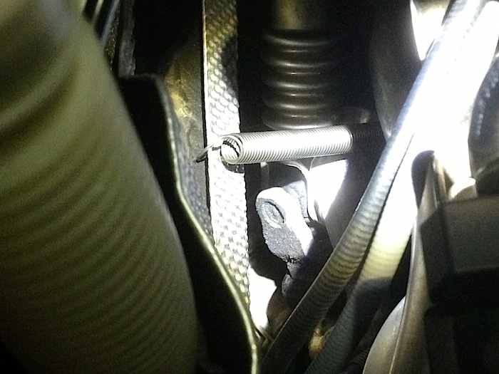

Great idea OP. Just did this and it works flawlessly.
Did you use the spring that he used? More pics of this install

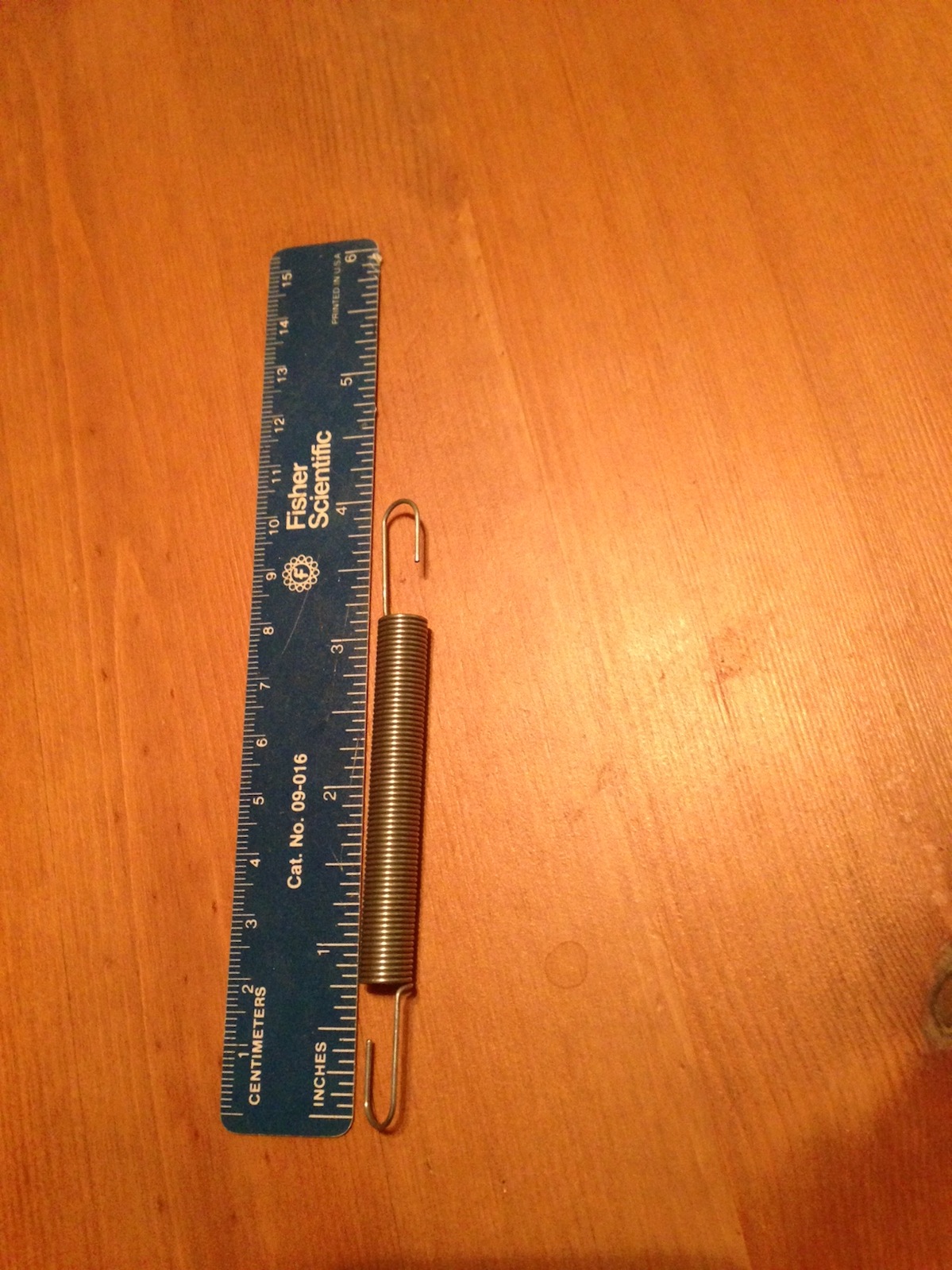

What's the length of the spring? I went to Home Depot but couldn't find #61....

Ace hardware it's a stock number from them #61
I can take mine out tomorrow and measure.

Similar spring. It measures approximately 5" long. My car is a RHD so the install is a little more complicated with the steering rack in the way. My car only has 18k miles on it and the wastegates rattle like hell (not tune related).

so is 5 inch spring the correct measurement to go by or the 2oz spring?

works really well I noticed a decrease in wastegate rattle noise....now is there anyway to get to the other wastegate actuator?

You mean 2oz weight?
Just use the spring

all i could find was a 4inch spring like the one posted above,would that be fine?
